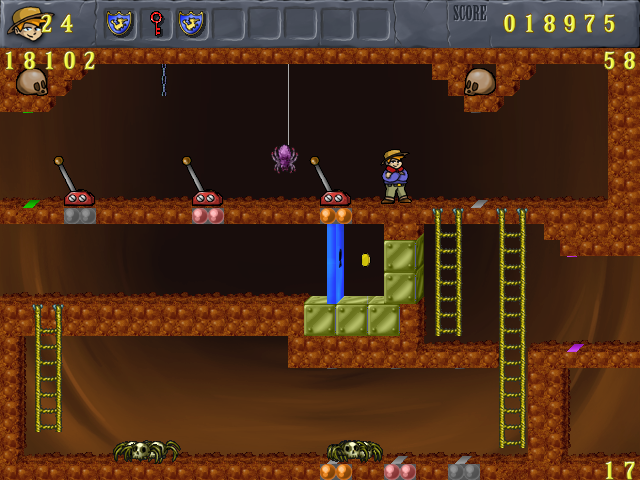

3222353C3C500 wrote: 18102: Jack figured out how to separate the spiders.  Easy when you know how.
Around noon Belgian time your text looked different ...
[smiley=lolk.gif]
I do hope that the coloured balls under the doors and levers are helping enough to keep the level 'normal'. What also helps is that the player endlessly may pull the levers till it suits.

About room 18102.
When Jack enters the room for the first time he has to go for the lantern which is inevitable for progress via the previous room.
At this point Jack can't go to the bottom floor since the grey door at his right is still closed. Leaves two options:
a. pulling the levers;
b. going back to the not-dark-anymore-room etc.
Do you think it is fair enough to offer Jack this dilemma? Wink Because option a is superfluous work.
477364656578010 wrote: About room 18102.
Don't see any problem with that.

18102
As promised. The added gold blocks guarantee fluid play between this and next room.
