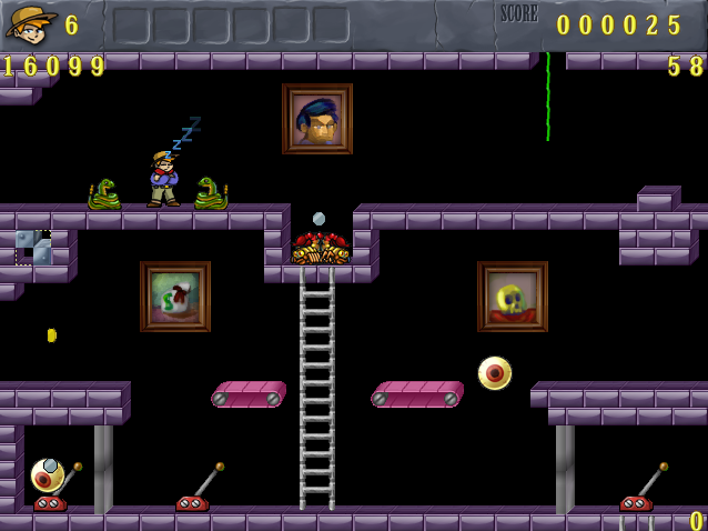

And picture 4 shows a room with an important lever in the lower left corner that leads to what I now officially declare as the GRAND PRIX BRELL.
[smiley=vrolijk_1.gif]
Btw, Jack isn't only dozing. He has a real nightmare! Already in the second room of the mansion he has a major problem. When he entered the room he saw 7 scorpions fall into the pit, a problem that he even can't solve by offering al his lives.

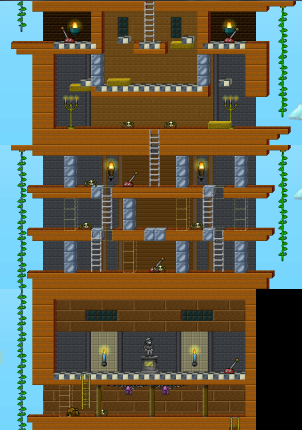

The transit zone contains 6 rooms and became a grown up. Image 1 shows what you may expect from that area: nearly everything from MM1 ! (There were also a few ghosts installed during the process, but I did remove them because they didn't fit with the other stuff.) Notice the coming back Elisabeth who is 'guarding' the save point. When you save over there, she reappears below your feet!! And as promised, in one of the other rooms you'll find the exit gate.
