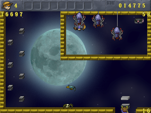

16697 In the room above, my Jack missed a jump and that is why he is hanging very dead near the left giant spider.
This room is cool because it gets complicated when the bird and the spider are moving together to the left (pic 1).

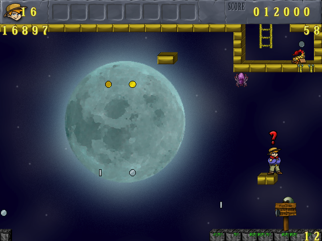

First of all I checked if awful things may happen during the sightseeing tour on the red platform. I was surprised that everywhere Jack committed suicide he reappeared in room 17099 at the spot where he jumped onto the red moving platform.
I found one single place where Jack could land alive and that was again that odd spot in room 16897 where you already added a skull and a sign. See pic 1. In the best case he uses the skull and continues to the right. Only the $ 250 from room 17099 stay out of reach.
But if Jack comes from Belgium Wink he uses the skull and moves left to die in the gap. Then he reappears endlessly ... See pic 2. My free suggestion is: remove the sign and the skull and add an always active horizontal mini-zapper beam on top of the bricks.

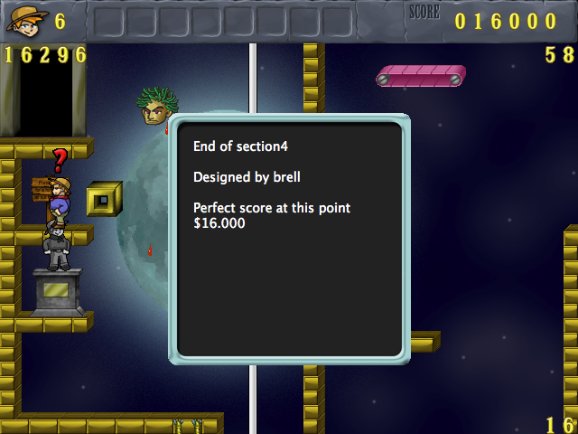

Only then I did a new effort to reach the exit door. Since I built up knowledge during previous efforts, everything went smoothly. See pic 3.
Nice and very spectacular work, brell !
